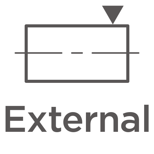

【 External 】
Cutting Time Tc
(Reference : n) [sec]
Tc
0
sec
Reset
Revolutions per Minute
n
[min
-1
Feed Rate
f
[mm/rev]
Length of Cut
L
[mm]
【 External 】
Cutting Time T
1
(Reference : vc) [sec]
T
1
0
sec
Reset
Cutting Speed
vc
[m/min]
Feed Rate
f
[mm/rev]
Length of Cut
L
[mm]
Diameter
Dm
[mm]

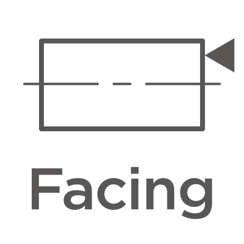

【 Facing 】
Cutting Time Tc (Reference : n) [sec]
Tc
0
sec
Reset
n
[min
-1
Feed Rate
f
[mm/rev]
Max. Diameter
D
1
[mm]
Min. Diameter
D
2
[mm]
Number of Pass
N
pass
【 Facing 】
Cutting Time T
1
T
1
0
sec
Reset
Cutting Speed
vc
[m/min]
Feed Rate
f
[mm/rev]
Max. Diameter
D
1
[mm]
Min. Diameter
D
2
[mm]
Number of Pass
N
pass

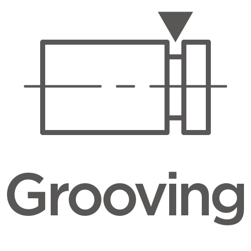

【 Grooving 】
Tc
0
sec
Reset
n
[min
-1
Feed Rate
f
[mm/rev]
Max. Diameter
D
1
[mm]
Min. Diameter
D
2
[mm]
【 Grooving 】
Cutting Time T
1
T
1
0
sec
Reset
Cutting Speed
vc
[m/min]
Feed Rate
f
[mm/rev]
Max. Diameter
D
1
[mm]
Min. Diameter
D
2
[mm]

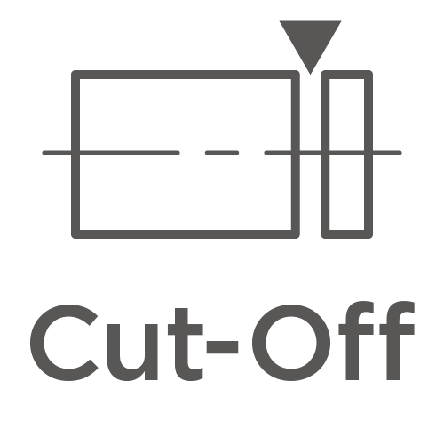

【 Cut-Off 】
Tc
0
sec
Reset
n
[min
-1
Feed Rate
f
[mm/rev]
Max. Diameter
D
1
[mm]
【 Cut-Off 】
Cutting Time T
1
T
1
0
sec
Reset
Cutting Speed
vc
[m/min]
Feed Rate
f
[mm/rev]
Max. Diameter
D
1
[mm]
Dia. at nmax
D
3
[mm]
【 Cut-Off 】
Cutting Time T
2
(Reference : vc:最高回転速度) [sec]
T
2
0
sec
Reset
Cutting Time
T
1
[sec]
Feed Rate
f
[mm/rev]
Dia. at nmax
D
3
[mm]
Max. Spindle Speed
n
max
[min
-1
