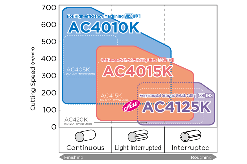

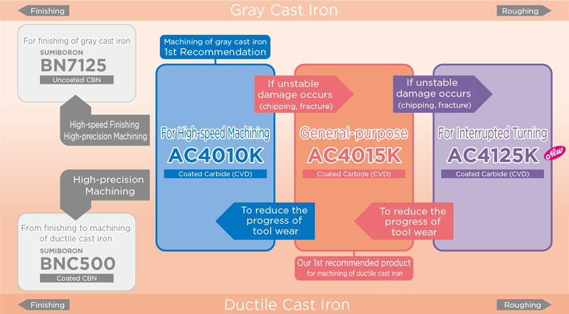

AC4115K
Our 1st recommended grade for turning gray cast iron. Also ideal for continuous turning of ductile cast iron. High-strength coating realizes stable and long tool life.
AC4125K
Our 1st recommended grade for turning of ductile cast iron. In particular, stable and long tool life can be achieved in the roughing of differential cases and carrier cases.

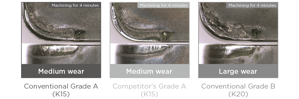

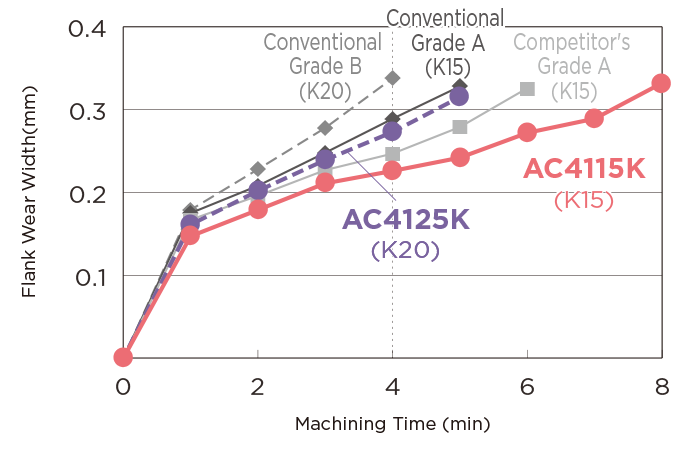

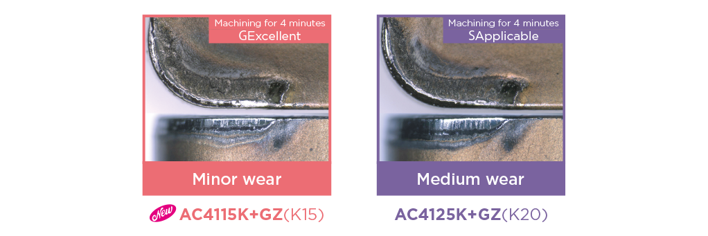

■ Wear Resistance of AC4115K/AC4125K (Continuous Turning of Ductile Cast Iron)
Significantly suppresses flank wear compared to conventional and competitors’ equivalent grades
Workpiece Material:FCD500 Continuous Turning
Insert:CNMG120408
Cutting Conditions:vc=200m/min f=0.3mm/rev ap=1.5mm Wet

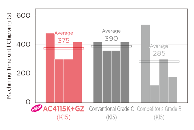

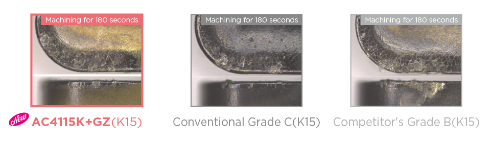

■ Chipping Resistance of AC4115K (Interrupted Turning of Ductile Cast Iron)
Maintains toughness equivalent to conventional grades
Workpiece Material:FCD700 Interrupted Turning
Insert:CNMG120408
Cutting Conditions:vc=200m/min f=0.25mm/rev ap=1.5mm Wet

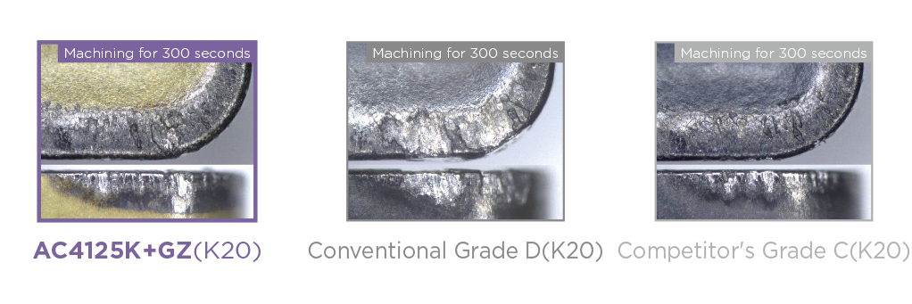

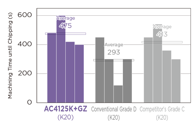

■ Chipping Resistance of AC4125K (Interrupted Turning of Ductile Cast Iron)
Suppresses cutting edge chipping for longer tool life
Workpiece Material:FCD450 Interrupted Turning
Insert:CNMG120408
Cutting Conditions :vc=450m/min f=0.3mm/rev ap=1.5mm Wet
