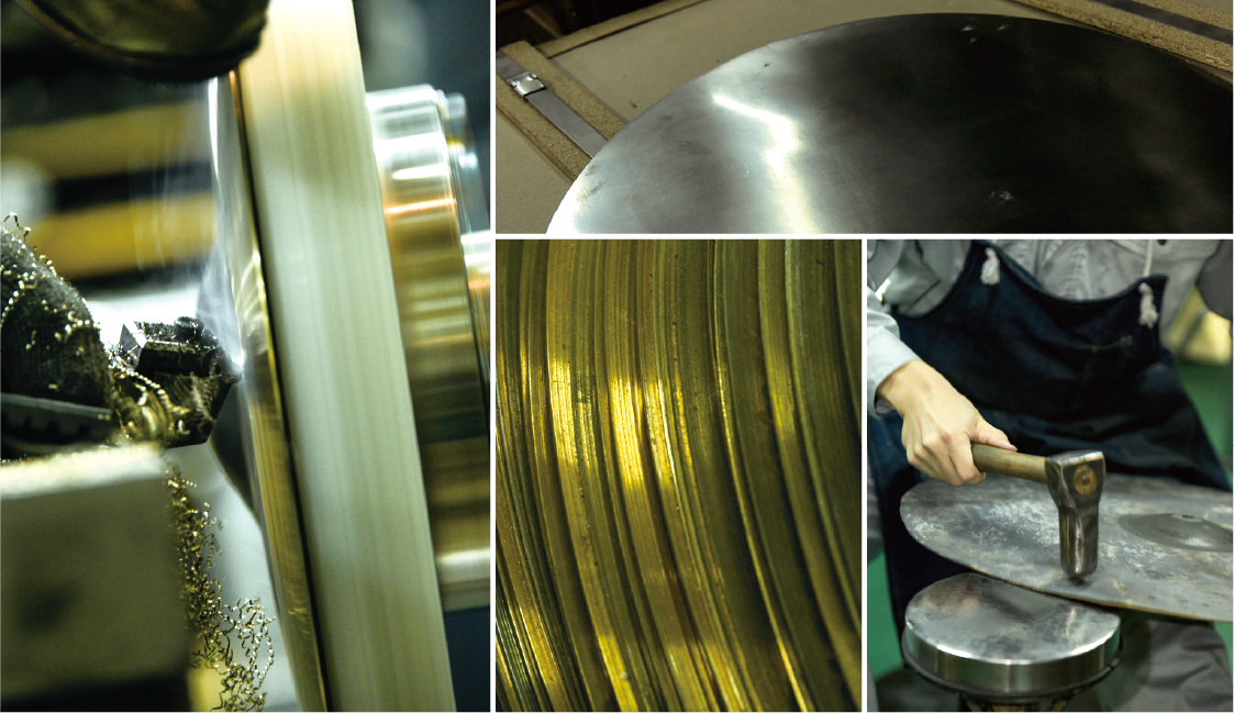

Cymbals made of bronze are said to have been produced since around 3000 BC. The manufacturing process is unique. High-tin bronze, an alloy of copper and tin, is fired in a furnace and then hot-pressed into a shape with a raised center while it is still soft. The material is then re-hardened several times and shaped by the spatula-drawing process. Then, the thickness and other details are adjusted by hammering and turning.
The shape and material determine the sound. The length of the vibration is adjusted by the number of hammering operations and sharpening. For example, increasing the number of hammers makes the vibration more complex, resulting in a softer sound and a cymbal for jazz.

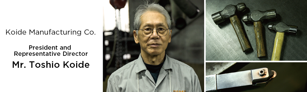

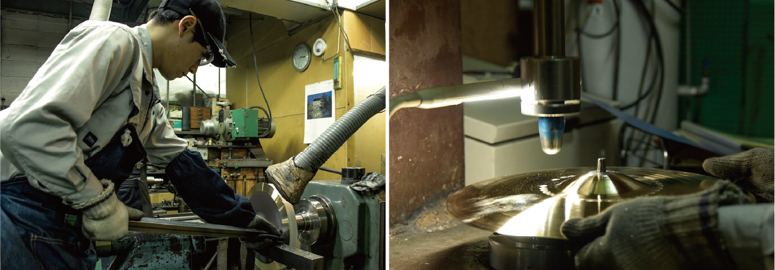

Processing was also an issue. The material is too hard and difficult to handle. There is a considerable deviation from the general feeling of metalworking," said President Koide. Moreover, hammering requires skilled workmanship, and it takes an hour and a half of continuous hammering to produce a single cymbal. The hammering process directly affects the vibration, so we made our own hammering machine that allows us to make cymbals in the same way as if they were struck by hand," says Koide.
The turning process, which transmits vibrations to the cymbal's surface and adjusts its thickness, also requires skill. It's a tricky process, so I made a lot of mistakes at first," he says. Carbide tools are used for the groove cutting edges, and diamond tools are the only tools that can compete with the hard materials covered with an oxide film. Ordinary copper alloys can be machined with HSS tools, but high-tin bronze is impossible.
