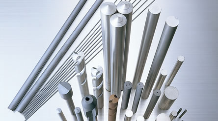

Cemented Carbide Rod Blanks
We offer the best IGETALLOY grades optimized for a variety of applications, including endmills, drills, and reamers; that demand strength, toughness and wear-resistance of the cutting edges.
  • Cemented Carbide Rod Blanks
  • Stocked Grades
    Super ultra fine grained carbide "AF1"
    Ultra fine grained carbide "A1"
    Fine grained carbide "H1"
    General cemented carbide "EH10"
    Other grades can be made-to-order.
    Product Configurations
    Standard sintered rods
    Endmill blanks
    Drill blanks
    PCB drill blanks
    Rod blanks with oil-holes
    Dimension of Standard Mill Scale Rod
    Outer diameter ø1.0 to 8.0mm (in increments of 0.5mm)
    Outer diameter ø9.0 to 20.0mm (in increments of 1mm)
    Length 50, 80, 100, or 310mm

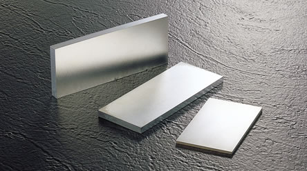

Cemented Carbide Plate Blanks
An extensive lineup of stocked grades including the super ultra fine grained carbide "AF1" for molds.
  • Cemented Carbide Plate Blanks
  • Stocked Grades
    "KH Series" KH03/KH05
    Dimensions of Stocked Plates
    Length 100mm, width 60mm, thickness from 1.2 to 4.0mm
    Length 150mm, width 60mm, thickness from 2.0 to 10.0mm

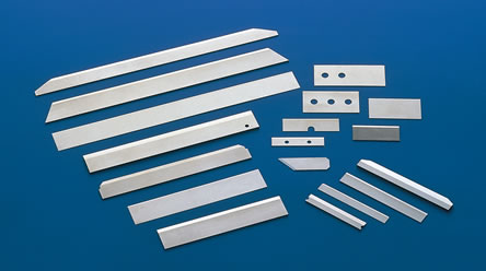

Cemented Carbide Thin Blades
The excellent edge integrity of ultra fine grained carbides exhibit superiority in cutting tape, fabric and paper.
  • Cemented Carbide Thin Blades
  • Stocked Grades
    Cutting Edge Shapes (Typical)
    Double-edged
    Two-stepped
    Drilled blanks
    Allowable Range for Manufacturing
    Min. thickness: 0.08mm, Max. length: 200mm (The straightness of thickness 0.08mm × length 200mm will be 0.1mm.)
