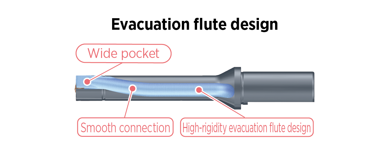

The challenge in developing indexable insert type drill lies in the trade-off between tool rigidity and chip evacuation capability. To smoothly lift and discharge chips, it is necessary to increase the capacity of the tool's evacuation groove, but this compromises tool rigidity. GDX series maintains chip evacuation capability while enhancing tool rigidity by meticulously adjusting this balance, enabling stable deep hole drilling.
The key lies in the design of the evacuation groove. Traditionally, the design of the evacuation groove has involved a strong twist to ensure sufficient capacity and facilitate chip lifting, but this led to problems with long groove lengths and chip discharge distances. Therefore, GDX series adopts a nearly straight evacuation groove shape, allowing for the shortest chip discharge possible. Moreover, as the tool tends to deflect more during deep hole drilling, by placing the terminal point of the evacuation groove in a location where the tool is less likely to deflect helps mitigate the shock when the tool enters the workpiece, thereby realizing maximum rigidity.

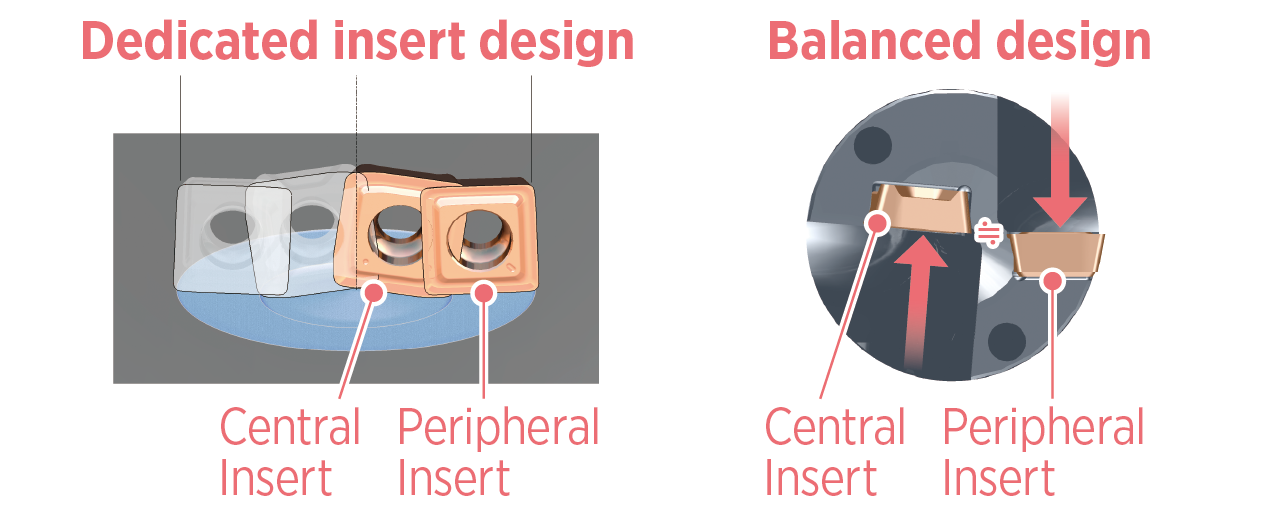

Due to the differing requirements for the center and peripheral inserts, separate designs were adopted. This design allows for the use of tough materials for the center insert and wear-resistant materials for the peripheral insert, capitalizing on our strengths in material selection for various applications, enhancing stability even under high-efficiency conditions. By selecting the optimal insert materials for the center and peripheral cutting edges, we have dramatically extended tool life.

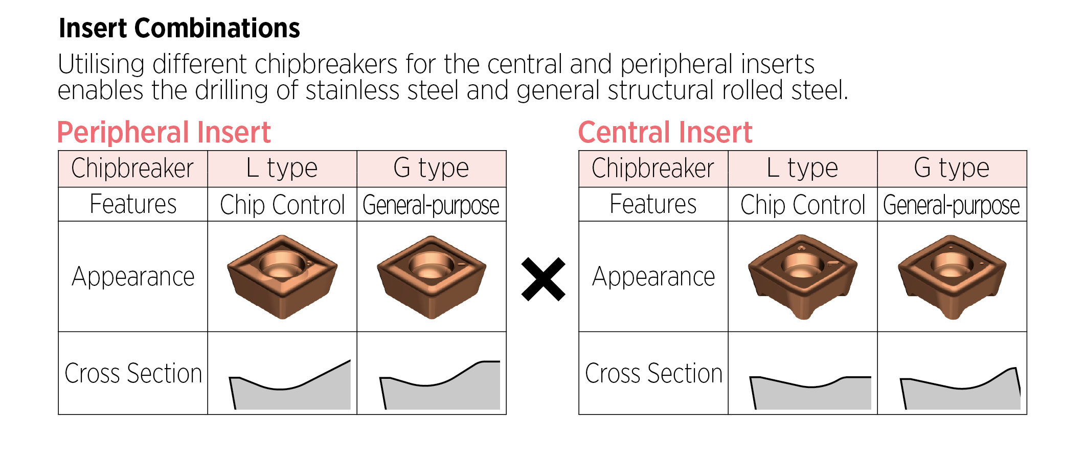

❸ Compatibility with low carbon steel.

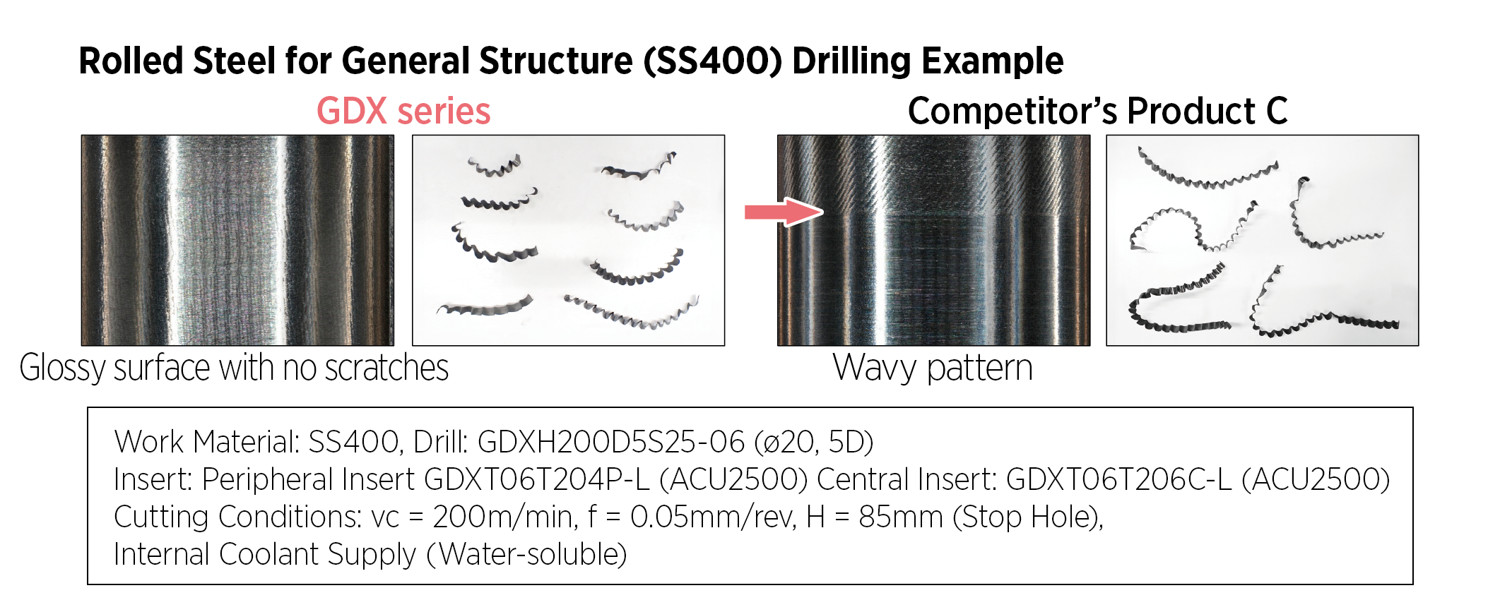

When machining low carbon steel or stainless steel, chips tend to tangle, and some customers have resorted to step drilling. To address this, we individually designed breakers for the center and peripheral inserts, significantly improving chip management performance.
Even with general structural rolled steel materials, where chips tend to extend easily, our design allows for fine fragmentation of chips, contributing to improved productivity. In pre-commercialization tests, many customers expressed surprise at the fineness of the produced chips.

Here are some points to more effectively use GDX series. Challenges related to deep hole drilling or long chip formation can be resolved by using high cutting speed and low feed rate cutting conditions, resulting in clean machined surfaces. For materials prone to long chip formation, combining an L type chip breaker for optimal chip management with high cutting speed and low feed rate cutting conditions will stabilize chip handling. If you encounter chip handling issues even in shallow hole machining, please give GDX series a try. To achieve stable machining and extend tool life, utilizing the specialized material ACP2000 for the peripheral insert will help suppress damage and prolong tool life.
