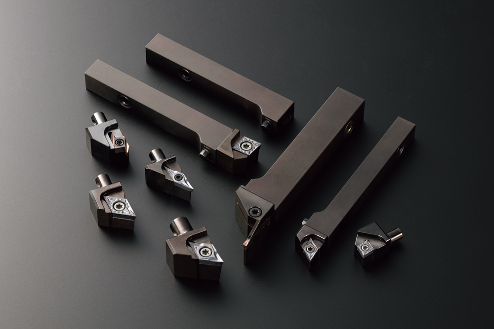

This product is easy to use as the head can be mounted and removed simply by operating the screw attached to the shank. In addition, the joint portion adopts a polygon taper to achieve a cutting edge repetitive accuracy of within 5μm. These features significantly reduce tool exchange time and contribute greatly to improved productivity.
apm.png Indexable Head Quick Change Holder APM type Small Lathe/Autolathe Tool

(1) High Repetitive Accuracy
The polygon shaped tapered joint and high-precision manufacturing realise cutting edge repetitive accuracy of within 5μm when exchanging heads.
*Does not include individual tolerances of the inserts.
(2) Diverse Lineup
The product lineup includes shank sizes of 10x10mm, 12x12mm, and 16x16mm, supporting various CNC autolathes. Tool holder heads support front turning (ISO insert), back turning and grooving applications, and can be used for various machining operations by just changing the heads.
(3) High Rigidity
Under CNC autolathe usage conditions, vibration and machined surface quality achieved are equivalent to those of integrated type holders.
(4) Internal Coolant Supply Without Hose
Compatible with internal coolant supply, cutting fluid discharge from the coolant hole near the insert rake face is supplied between the chips and the rake face while maintaining high pressure, breaking the chips into small pieces and achieving excellent chip evacuation. Coolant port on the toolpost contact surface also supports coolant supply without using a hose, eliminating piping setup and preventing chips from wrapping around the hose, thus reducing downtime.
