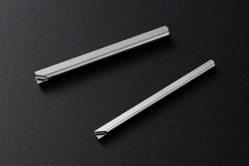

In response to these needs, our company has developed and launched for sale the Small-Hole Boring Bar DABX type, which enables ø3mm and ø4mm internal boring through the use of the nano-polycrystalline diamond SUMIDIA™ BINDERLESS on the cutting edge, enabling cemented carbide machining over longer periods.
SUMIDIA™ BINDERLESS Small-Hole Boring Bars DABX type for Internal Boring of Cemented CarbideSUMIDIA™ BINDERLESS Small-Hole Boring Bars DABX type for Internal Boring of Cemented Carbide
Small-Diameter Boring Bar DABX type used for internal boring of cemented carbideSmall-Diameter Boring Bar DABX type used for internal boring of cemented carbide

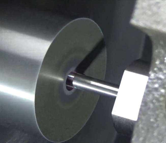

(2) Supports small-diameter internal boring up to ø3mm and ø4mm
High-rigidity shank material and geometry realises excellent machined surface quality even in small-diameter internal boring of ø3mm and ø4mm.

Small Diameter Boring Bars (Grade: NPD10)   6 Cat. Nos.
