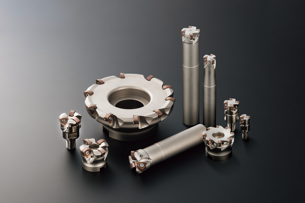

In response to these needs, our company has developed the new SEC-Sumi Dual Mill™ DMSL series. While the DMSW series, available from June 2021 on, has a lineup of cutters from ø40 to 160mm, the DMSL series has a minimum diameter of ø16mm. This lineup of diverse diameters is applicable to various machining applications in fields including automobiles, aerospace, industrial machinery and molding.
SEC-Sumi Dual Mill™ DMSL series / DMSW series
1. Features
(1) Supports high-efficiency machining with ultra-high-feeds and large depths of cut
The complex arc-shaped cutting edge enables optimal cutting angles suited to the axial depth of cut; maximum 3.5mm/t ultra-high-feed machining is realised in areas where depths of cut cannot be increased, and over 1.5mm/t machining with large depths of cut in areas with low feed rates.
(2) Stable long tool overhang machining
Small cutting angle controls cutting resistance towards the back force direction. This enables stable machining without chatter even with long tool overhang.
(3) Realises excellent surface roughness even in ultra-high-feed machining
The complex arc-shaped cutting edge works like a wiper edge to suppress severe deterioration of the machined surface finish even during ultra-high-feed machining.
