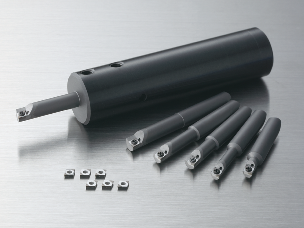

Our company's Small Diameter Boring Bars SEXC Type, with minimum bore diameter of ø4mm, realise high-rigidity machining and high-accuracy cutting edge position by using a carbide holder with a positioning mechanism. In addition, with indexable 2-cornered inserts, this product has contributed to lower costs in machining of hardened steel.

(1) Indexable inserts with a min. bore dia. ø4mm
Small indexable inserts realise a minimum bore diameter of ø4mm.
(2) High-accuracy cutting edge positioning
Achieves high-precision cutting edge positioning thanks to our proprietary clamp mechanism.
