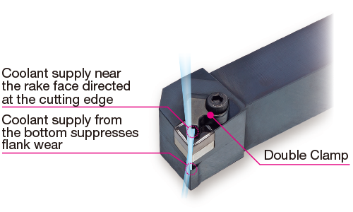

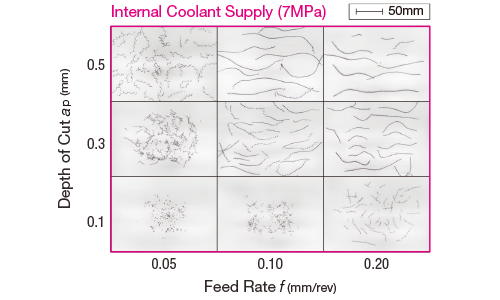

● Enables directed coolant supply from a close range, towards the cutting edge

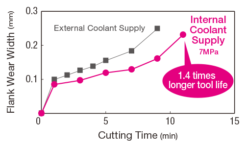

● Suppresses flank wear with additional coolant supply to the flank face
● Realises high rigidity and indexing accuracy with double clamping
