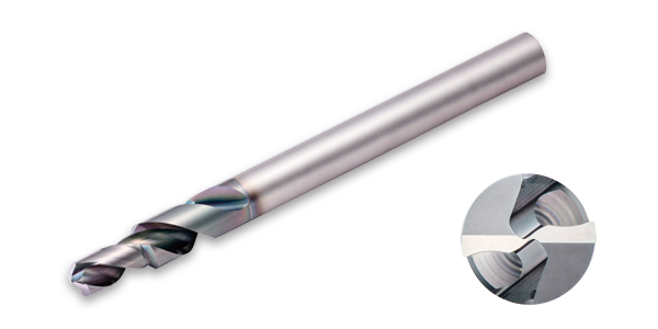

For Ring Gear Mounting Hole DrillingHigh-efficiency Drills
2x conventional feed rate f = 0.4 to 0.5mm/rev possible
• Our proprietary low-resistance cutting edge design realises high-efficiency drilling.
• High efficiency reduces power consumption by about 40%, contributing to energy savings toward SDGs. -

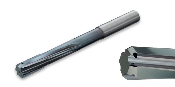

SumiReamerSSR series
•A balanced design that combines sharpness and cutting edge strength, to achieve high feed rate of f=1.6mm/rev.
Diameter: ø2.97 to 12.0mm

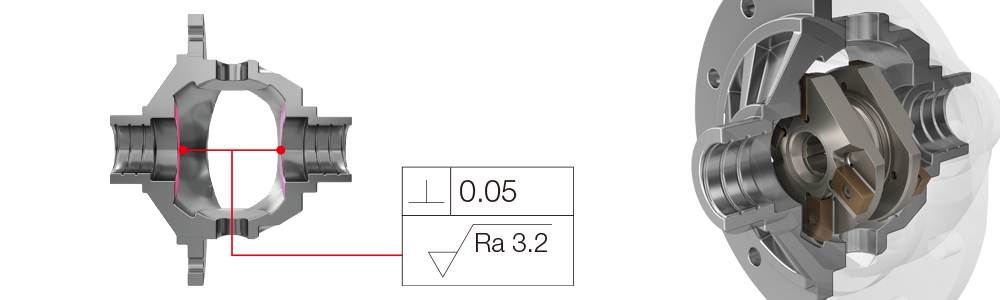

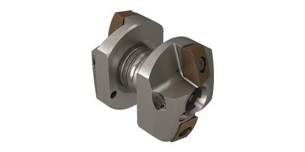

Turning

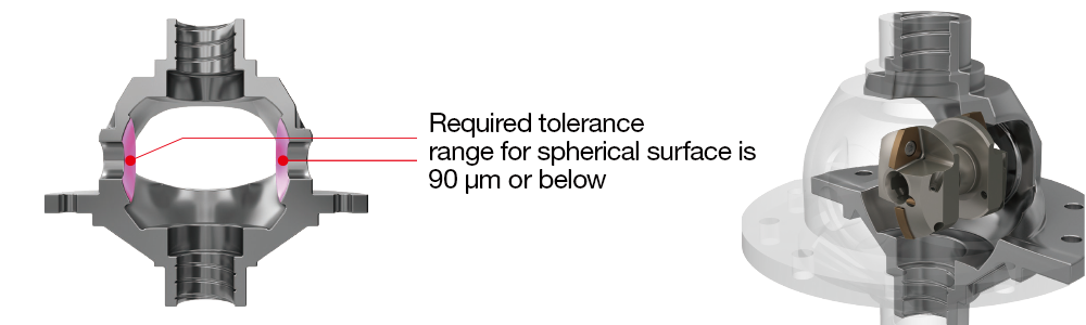

Spherical Cutters
Available sizes: Consult us (actual sizes supported so far: ø35 to 64mm)
Required tolerance range for spherical surface is 90 μm or below

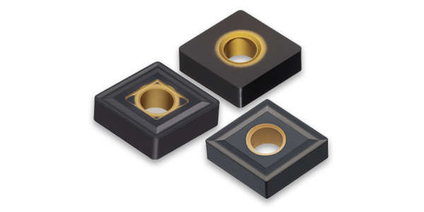

Lay-flat Insert type
• Ideal for small differential case machining.

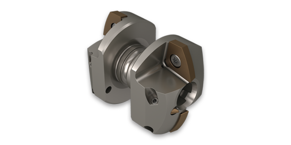

Tangential Insert type
• Tangential mounting increases insert rigidity, ideal for high-feed and highefficiency machining.

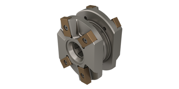

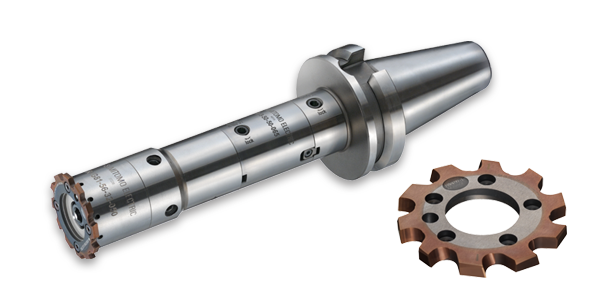

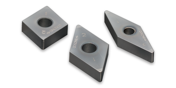

Face Milling Cutters
Available sizes: Consult us (Actual sizes supported so far: ø48 to 100mm)
• Special cutter for dedicated machines achieves outstanding mass production performance.
• High-precision cutter body and ground type insert support stringent machining accuracy.
• Highly economical with indexable inserts.
