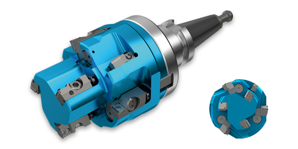

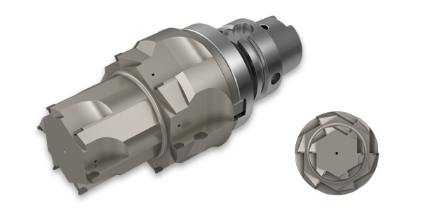

1-Pass Roughing and Finishing Tool
Capable of machining in 1 pass! Tool count reduced. Contributes to reduced cycle time
Cartridge type
• The use of three formed inserts enables one-pass finishing even on pre-cast hole work with large variations in machining allowance.
•The introduction of a parallel adjustment mechanism maintains high squareness accuracy even when diameter height is adjusted.
• Utilising an aluminum alloy body enables usage on small M/C with weight limitations. -
Brazed type
• By brazing the PCD cutting edges directly to the body, the number of effective cutting edges can be increased (from 3 to 6), achieving even higher machining efficiency.
(Indicates A.L.M.T. Corp. products.)

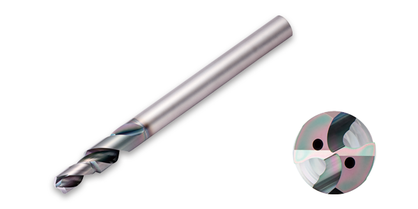

For Pre-cast Hole DrillingDLC Coat Drill
• Positioning accuracy for ø0.4 and below is possible even at feed rate of f=1.0mm/rev
• Special flute design achieves both drilling accuracy and high efficiency, even in pre-cast hole drilling where hole positions tend to be misaligned.Diameter: ø5.0 to 12.0mm (Large dia. max. ø16.0mm and below)

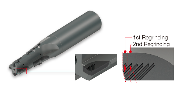

RegrindablePCD Reamer with Chip Breaking Function
• Special chipbreaker shape improves chip breaking.
• It is possible to regenerate a new chipbreaker upon regrinding.
• Applicable feed rate range is f = 0.2 to 0.4 mm/rev (4 flutes).Diameter: ø5.0 to 80.0mm
