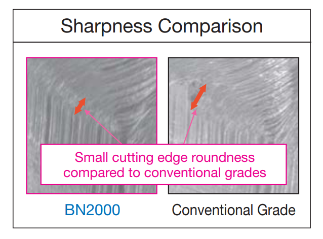

Significant improvements in the performance of both by employing a high-purity ceramic binder.
Stable surface roughness achieved by increasing edge sharpness.
