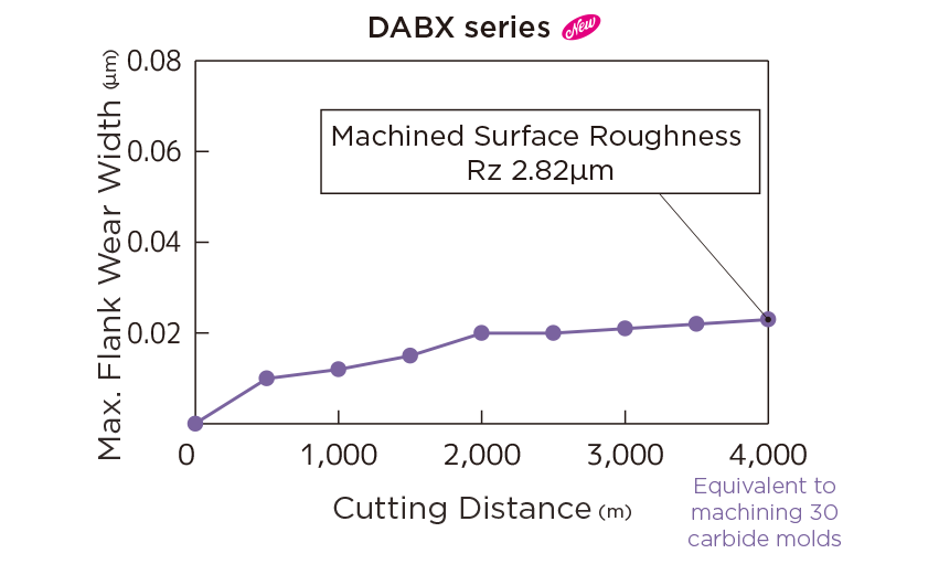

Superior wear resistance maintains cutting edge sharpness for a long time

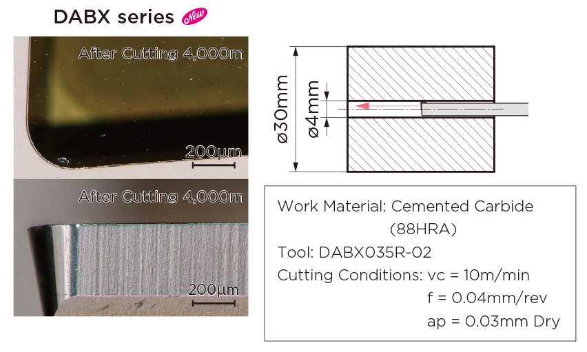

Wear resistance evaluation on cemented carbide (88HRA)
Minimal wear even after cutting distance of 4,000m

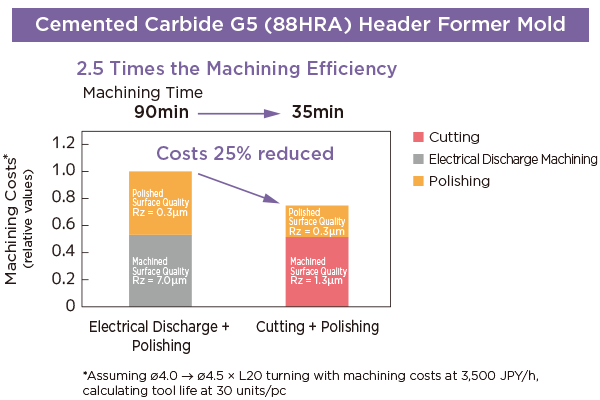

Utilising cutting to reduce machining time and total costs
Switch from electrical discharge machining (EDM) to cutting
Switching from EDM to cutting - Surface roughness of cutting: Rz1.3μm, against Surface roughness of EDM: Rz7.0μm, thus Shortening time for polishing (Rz0.3μm)
Achieving 2.5x higher machining efficiency with 25% total cost reduction.
