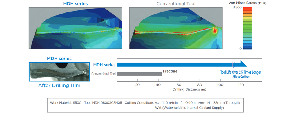

Low cutting resistance stabilizes high-efficiency drilling
RP THINING
Wide chip pocket enables smooth chip evacuation and reduced cutting, resistance ensuring stable drilling even in high-efficiency conditions
Unlikely to fracture even in high-efficiency drilling

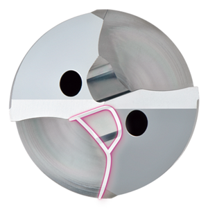

New Cutting Edge Shape
Optimised cutting edge shape suppresses stress concentration and prevents chipping even in high-efficiency drilling with high cutting edge load

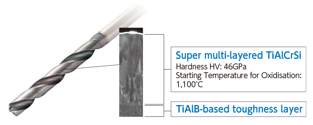

TiAlCrSi-based super multi-layered coating realises excellent wear resistance and thermal resistance
Tough TiAlB-based coating is employed on the carbide substrate to improve coating strength and fracture resistance
