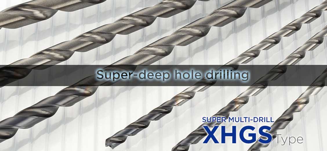

    Super MULTIDRILL XHGS series/PHT series
