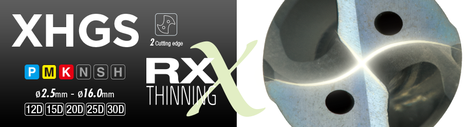

Super MultiDrill XHGS type is the next generation drill for super-deep hole drilling with stable chip evacuation and improved toughness for even higher efficiency drilling.
Special thinning profile reduces cutting forces during high efficiency drilling
Utilizing a special “RX-thinning” profile that reduces cutting forces during high efficiency drilling
Utilizing a new “J-flute” for improved stability and chip control during deep hole drilling
Utilizing “DEX Coat” exclusively for drills, to achieve long tool life for a variety of work materials

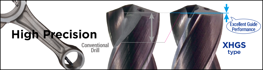

High precision
As compared to conventional, the distance from the cutting edge (main margin) to the sub-margin is shortened to provide stable and vibration-free machining right from the start of drilling.
