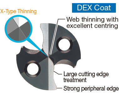

Suitable for high-efficiency drilling of general steel
Excellent cutting edge strength
Large edge treatment is used to reduce breakage of the cutting edge.
Stable machined hole accuracy
X Type thinning achieves excellent centring on entry and stable drilling.
