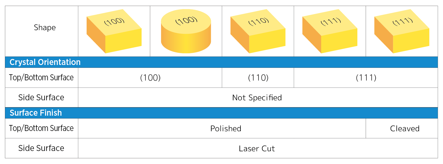

| Type | High Pressure High Temperature(HPHT) Type Ib |
| Nitrogen Content | 102 ppm (Not Guaranteed) |
| Color | Yellow |
| Electric Resistivity (Ω⋅m) | ~1014 |
| Thermal Conductivity (W/(m⋅K)) | < 2,000 |
| Crystal Orientation | Main Face : (100), (110), (111) Side Face : Indeterminate (Can Not Specified) |
| Size Tolerance | Length : ±0.1mm (Guaranteed Only on Smaller Side), Thickness : ±0.1mm |
| Surface Finish | Main Face : Polished or Cleaved on Both Sides Side Face : Laser Cut |

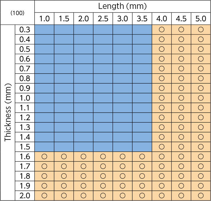

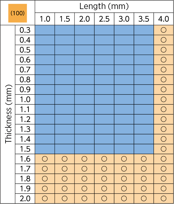

SUMICRYSTAL Substrates(100)

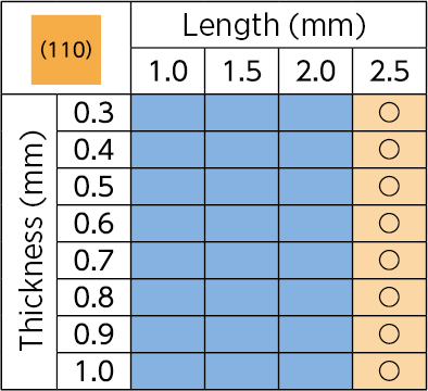

SUMICRYSTAL Substrates(110)

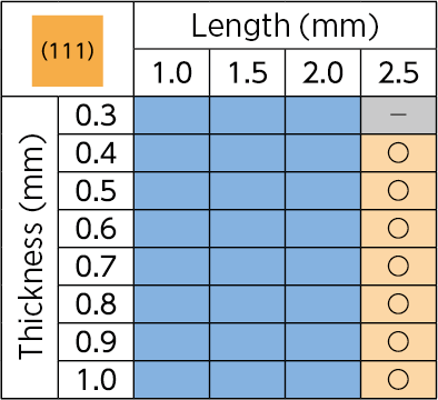

SUMICRYSTAL Substrates(111)

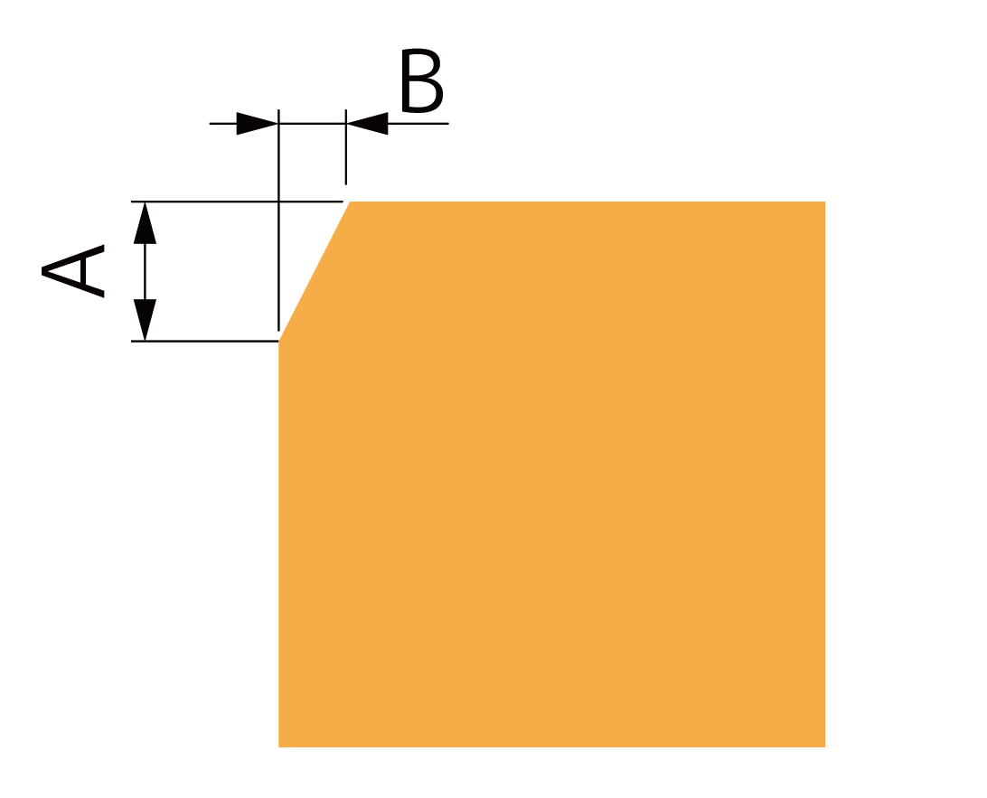

■ Corner Cut (Optional)
Corner cut for identification is available.
Outer Size <3x3mm AxB=0.3x0.15mm,
Outer Size ≧3x3mm AxB=0.6x0.3mm

5mm dia or 4×4mm for (100) type, 2.5×2.5mm for (110) & (111) type.
