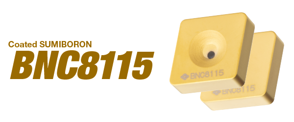

Coated SUMIBORON BNC8115

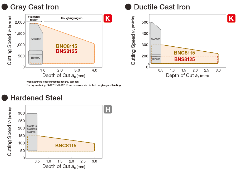

PVD coating with excellent wear resistance suppresses flank wear in machining of exotic alloy cast iron and hardened steel
Ideal for roughing and 0.5mm to 0.3mm depths of cut can also be used for roughing and finishing of grey cast iron
Gold-colored coating for improved visibility of used corners

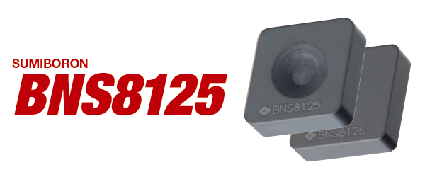

SUMIBORON BNS8125
Optimising the particle size distribution of the CBN particles has resulted in improved chipping resistance and longer life while maintaining wear resistance during grey cast iron machining
