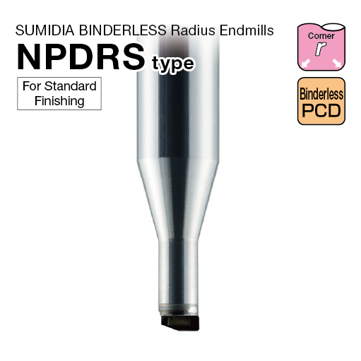

NPDRS type
For Finishing of Cemented Carbide and Hard Brittle Materials

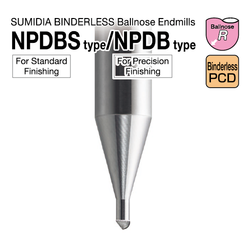

NPDBS type/NPDB type

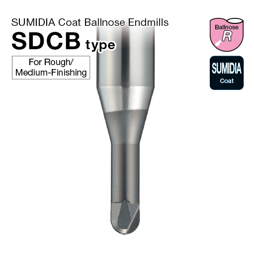

SDCB type
For Rough/Medium Finishing of Cemented Carbide and Hard Brittle Materials

Mold Finish Master SUMIDIA BINDERLESS Ball-nose Endmills "NPD series"
The NPD series achieves direct mirror finishing of carbides, which is impossible for existing single-crystal or polycrystalline diamonds, by utilizing a harder nano-polycrystalline diamond cutting edge.
Ideal for Finishing of Hard, Brittle Materials Including Carbide
Provides excellent machined surface quality thanks to the sharp cutting edge and optimized edge treatment.
Enables High-Precision Machining and Achieves Long Tool Life
Maintains excellent dimensional accuracy for a long time thanks to the high contour accuracy of the cutting edge and the excellent wear resistance of diamonds.
