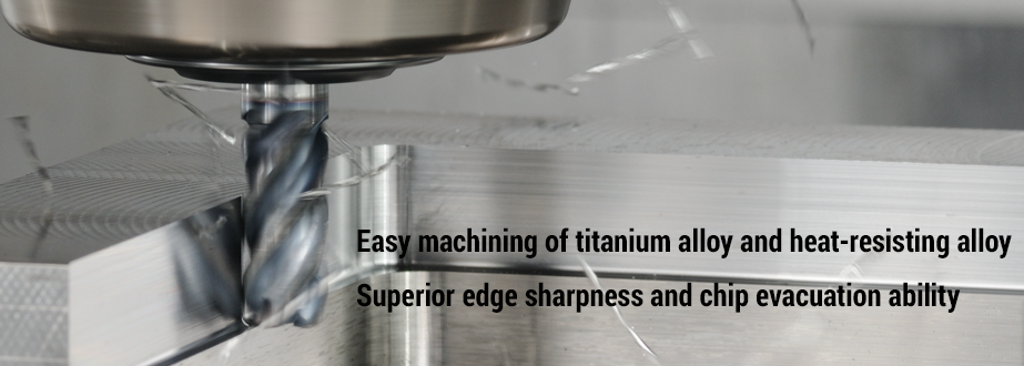

Adopts a strong helical angle to provide improved edge sharpness with smooth and reliable chip evacuation

Superior edge sharpness and chip evacuation ability
Adopts a strong helical angle (45° helical) to provide improved edge sharpness with smooth and reliable chip evacuation.

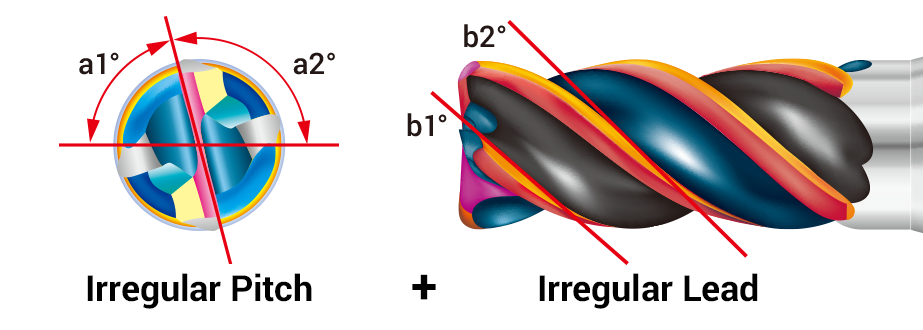

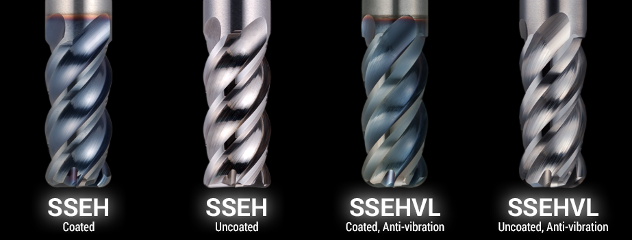

Anti-vibration type added to the SSEH series endmill for exotic alloys
Builds on the same features of the existing series by adding an irregular lead for exceptional anti-vibration abilities
For a wide variety of exotic alloys including SUS, inconel, titanium etc.
Minimizes chatter to achieve high speed, high feed machining
Both coated and uncoated types are available in stock to meet various requirements
