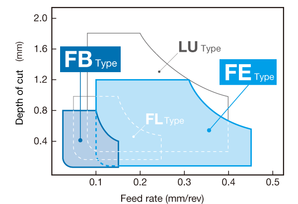

Excellent chip control! 2 types of chip breakers cover wide range conditions of feed!!
Work Material
Video
Feature

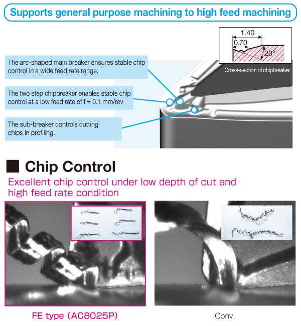

・2 types of chip breakers cover wide range conditions of feed!!
・Extensive product lines are available to meet various machining requirements.
・The positive insert chipbreaker FB type is also availabe.
FE type
Work material : STKM13A (Pipe steel)
Insert:CNMG120408N-FE (AC8025P)
Cutting conditions: vc=200m/min , f=0.4mm/rev , ap=0.2mm , Dry

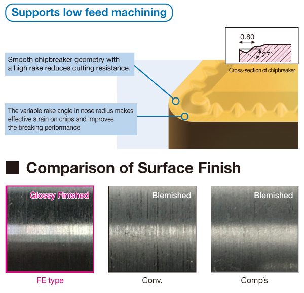

FB type
Work material:SCM415
Insert:CNMG120408N-FB (T1500A)
Cutting conditions: vc=200m/min , f=0.1mm/rev , ap=0.5mm , Wet
