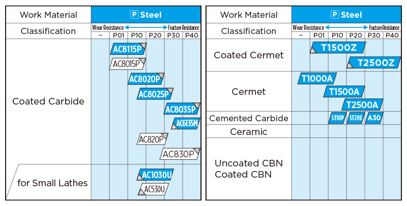

Grades Selection (Turning)
General Steel , Soft Steel P
Coated Carbide
AC8000P Series
AC8115P
Advancement in fine crystal alumina grain orientation control technology greatly reduces the progress of crater damage. Achieves excellent wear resistance in high-efficiency and dry machining.
AC8020P
Alumina coating with even higher strength balances outstanding stability and wear resistance in mill-scale work on forged material. Gold-colored coating makes used corners easily identifiable
AC8025P
Our 1st recommended grade for turning steel. Surface smoothing technology significantly suppresses adhesion of work material components. Achieves long, stable tool life with various cutting speeds and work materials
AC8035P
Tensile stress removal of the coating layer greatly improves fracture resistance. Achieves long, stable tool life during heavy interrupted cutting

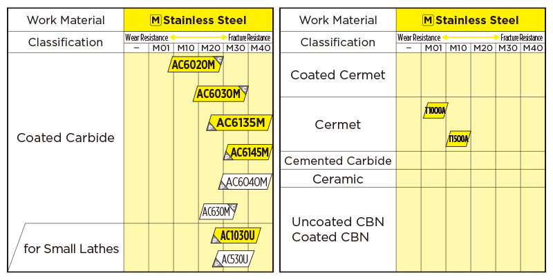

Stainless Steel M
Coated Carbide
AC6000M Series
AC6020M
Combines a high-hardness carbide substrate with excellent wear resistance and a new CVD coating with improved coating strength to achieve both excellent wear resistance and fracture resistance. Achieves long, stable tool life during high-speed cutting
AC6030M
Our 1st recommended grade for turning of stainless steel, achieving long and stable machining. Drastically reduces the abnormal damage common in stainless steel machining, thanks to the improved coating strength and excellent adhesion
AC6135M
Balances excellent wear resistance and fracture resistance in light interrupted turning and mill-scale work through the use of new PVD coating.
AC6145M
The combination of a PVD coating and a high-toughness carbide substrate realises absolute stability in heavy interrupted turning.
For Small Lathes
AC1030U
High-quality cutting edge grade suppresses adhesion and micro-chipping, realizing excellent machined surface quality
Cermet
T1000A/1500A
T1000A
High-hardness cermet with outstanding wear resistance and toughness. Realises high dimensional accuracy for continuous steel machining or finishing of powdered metal or cast iron
T1500A
A general-purpose cermet made from hard grains with different grain sizes, delivering functionality that provides an excellent balance of wear resistance and toughness, along with good surface finish quality

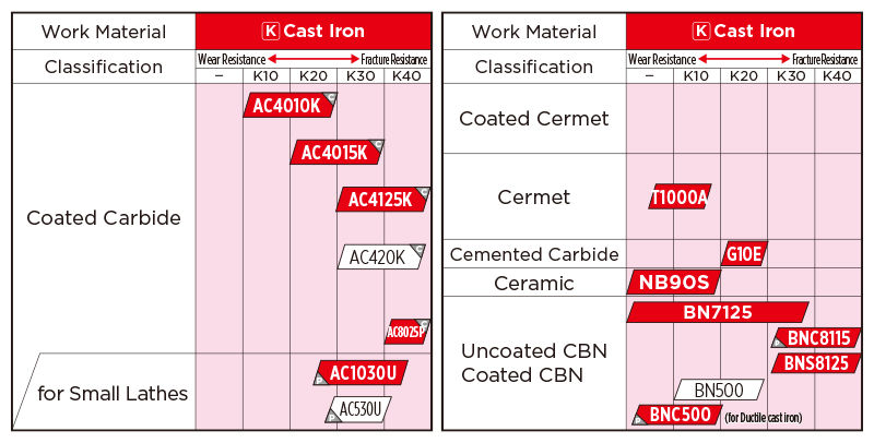

Cast Iron K
Coated Carbide
AC4000K Series
AC4010K
Superior wear and plastic deformation resistant grade, that utilizes a high hardness carbide substrate coupled with the high hardness Super FF Coat for high speed to continuous turning of Cast Iron
AC4015K
Our 1st recommended grade for ductile cast iron. New high-adhesion, high-strength CVD coating realises both wear resistance and chipping resistance
AC4125K
Our 1st recommended grade for interrupted turning of cast iron. Especially effective for stable long life in roughing of parts like differential cases and carriers.
For Small Lathes
AC1030U
Cermet
T1000A
Uncoated CBN
BN7125
General-purpose grade with excellent wear resistance, fracture resistance, and thermal shock resistance, suitable for machining of cast iron and exotic alloys
BNS8125
Grade with 100% solid CBN structure that exhibits excellent wear and fracture resistance
Coated CBN
BNC8115
Grade with 100% solid CBN structure, using PVD coating with excellent wear resistance to enable roughing operations

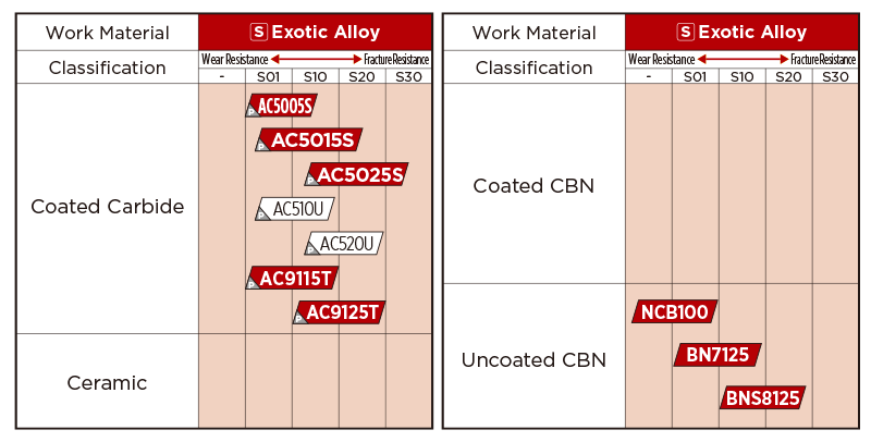

Exotic Alloy S
Coated Carbide
AC5000S Series
AC5005S
High-speed, high-efficiency grade with great high-temperature strength, which realises excellent wear resistance in high-efficiency machining
AC5015S
Our 1st recommended grade for turning exotic alloys as it realises stable tool life with high-speed, high-efficiency machining
AC5025S
High-toughness grade for realising stable tool life for interrupted cutting machining or mill-scaled work
AC9100T Series
AC9115T
First recommended grade for exceptionally long tool life in a wide range of applications.
AC9125T
High-toughness grade realising exceptionally long tool life in interrupted turning.
Uncoated CBN
NCB100
Achieves high-efficiency, improved machining accuracy, and long tool life in machining of exotic alloys such as titanium alloy and Co-Cr alloys
BN7125
BNS8125

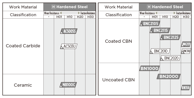

Hardened steel H
Coated Carbide
AC5005S
Coated CBN
BNC2125
1st recommended grade, balancing excellent wear resistance and fracture resistance in hardened steel machining.Along with a tough CBN substrate, the coating combines wear resistance and toughness to achieve long, stable tool life even in high-efficiency and interrupted machining
BNC2115
High-precision grade realizing long tool life with excellent surface roughness and stable machining. Maintains excellent surface roughness thanks to a high notch-wear resistant coating and tough CBN substrate
BNC2105
Grade for high-speed finishing. Stable performance in high-speed turning of hardened steel, thanks to outstanding wear resistance.
BNC2135
Utilising a highly fracture-resistant coating and a high-strength substrate to achieve long and stable tool life in interrupted turning.

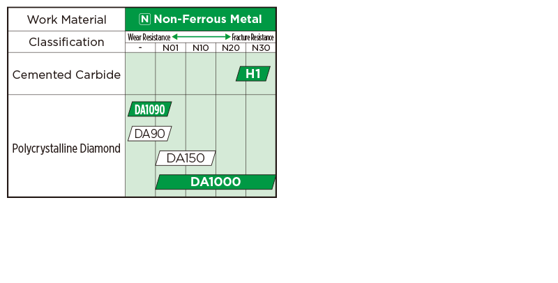

Non-Ferrous Metal N
PCD
DA1090
A polycrystalline diamond material with the highest diamond content, made by sintering coarse diamond particles at high density. High density and enhanced particle binding strength exhibit excellent wear and fracture resistance.
DA1000
High-density sintered material made of ultra-fine grain diamond that demonstrates optimum wear and fracture resistance and excellent edge sharpness

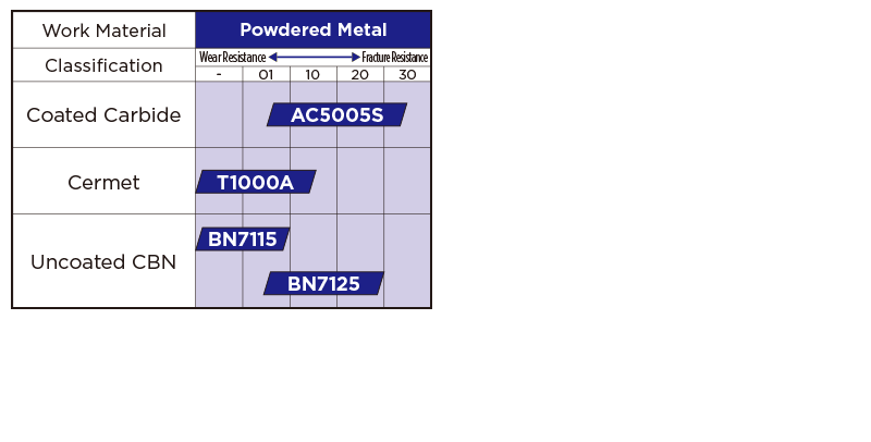

Powdered Metal PM
Coated Carbide
AC5005S
Cermet
T1000A
Uncoated CBN
BN7115/BN7125
BN7115
Grade balancing ultimate cutting edge sharpness with fracture resistance, suitable for finishing of sintered alloy
BN7125

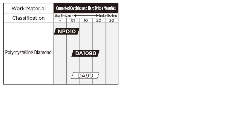

Cemented Carbides and
Hard Brittle Materials
CC HB
PCD
NPD10
100% diamond that directly binds nano-order diamond particles with high strength. Demonstrates optimum wear and fracture resistance as well as the best edge sharpness
DA1090
